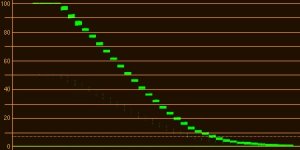

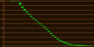

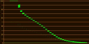

ok, so I have just tested CPF 2.1 and 3.0...
I don't like 2.1 at all; it tries very hard to see a bit more into the highlights, fails miserably (just like any other option: it's just a hard clip that no picture style will avoid), and in the process throws away 25% of the codec's color space
now, 3.0 is a lot better in this respect; at least in the luminance channel, it is, as you noticed, relatively similar to flaat_2
this is cpf 3.0:
and this is flaat_2:
close, but flaat_2 looks a lot better:
* much smoother response to light (and in particular, no wiggling)
* somewhat higher DR (0.66 stops?)
