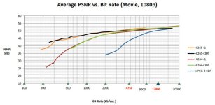

At equal bitrates, especially on the low end, prores will give you a much crappier image than H265. Look at a ProRes proxy file and compare to an H265 file with the same bitrate.
It's hard to find head-to-head matchups of prores and h265, but here's one that someone on eoshd did using a program that compares "SSIM" scores (something to do with deviation from a full-quality source image):
The following is what I've seen much more often, a comparison of PSNR between H265 and H264:
So, while you could deliver ProRes files with small bitrates, they will look much worse than H265 files with equal bitrates, and the only advantage (assuming that both are 422) is that the ProRes would be easier to play back. But if your system has H265 hardware acceleration, then you probably won't have any trouble anyway. The higher quality of prores is linked to the higher bitrate.
