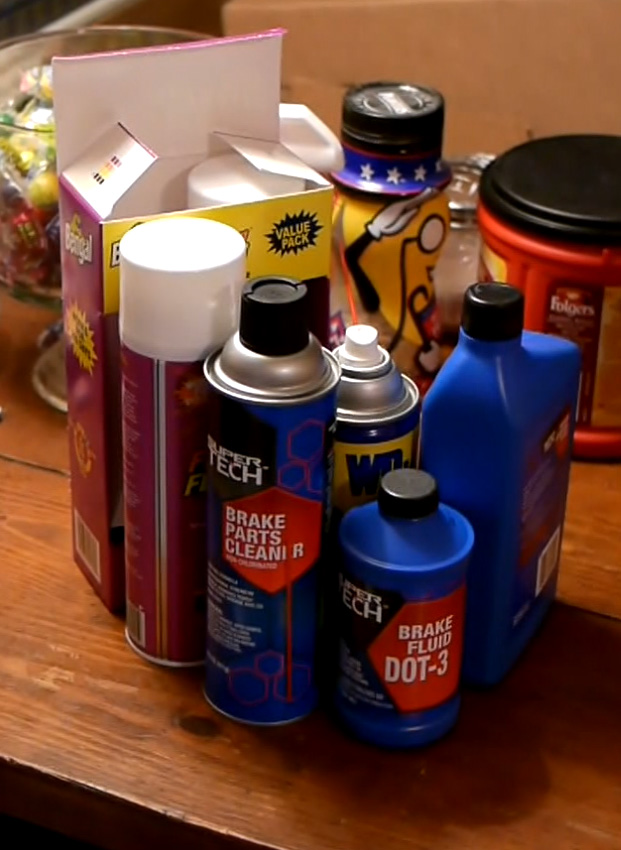

Here a comparison using the same method to capture the screen grab which clearly shows the difference:
Using the same source MTS video file from my GH1.
First Screen Grab
Neo Scene processed 1080 GH1 clip to convert to a true 24p file - imported into Edius 1080 24p timeline - exported as 1080 24p
Things to notice:
Thin edges on cans are smooth, no interlace artifacts, but the black levels are crushed compared to the original MTS file. The black levels dropped in Edius for some reason. The same Neo Scene file in Sony Vegas will not drop the black levels.

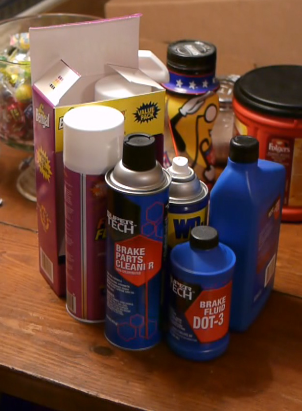

Second Screen Grab
Original MTS 1080 GH1 clip - imported into Edius 1080 24p timeline - exported as 1080 24p (same export settings were used for both clips)
Things to notice:
Thin edges on cans have interlace artifacts, box edges have interlace artifacts. Retains the same video levels of the original MTS file.
Randy
