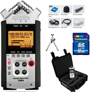

I ordered this H4n package today, looks like a good deal-- comes with 16GB class 6 card, nice hard protective travel case. $319 free shipping. Not much price difference from H4. I thought of dumping my H4 on ebay but decided to keep it as a backup digital field recorder.

what's the difference between the zoom h4n and h4 (as far as price and performance)?
The H4n replaced the H4. With the H4n, internal pre-amps were improved (pre-amps in the original H4 were terribly noisy), and the on-board stereo mics have an adjustable width of image. The chassis was redesigned to be more ergonomic and to transmit less handling noise. It also has the added feature of being able to record both external mics via the XLR ins and the built-in mics simultaneously in 4-track mode.
The one thing they ruined in the upgrade is that the H4n does not have the ability to take line-level inputs like the H4 did. So between the two, the H4 dominates as a line-level recorder with an external mixer on the front end, and the H4n dominates as a portable recorder with external mics.
