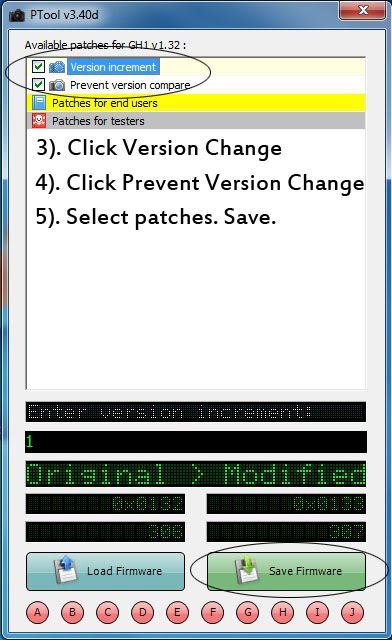

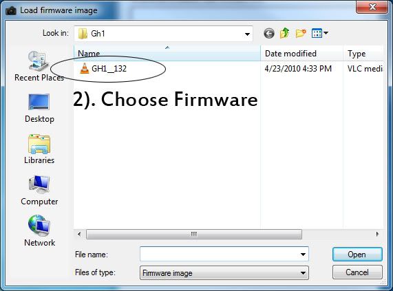

I've seen way too many questions regarding how to use the ptool. That's understandable. But it's ongoing and needs to addressed. So here are some steps from beginning to end on how to use it. Hope this helps.

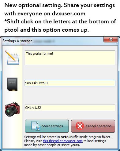

***Go here to input your settings***
*** http://bit.ly/PToolsForm ***
***Go here to view settings***
*** http://bit.ly/PToolsList ***
***Go here to view successful settings for MJPEG and AVCHD***
*** http://www.dvxuser.com/V6/showthread.php?t=213486 ***

If version number increases to 1.41 or beyond and next Panasonic official firmware is version 1.40, are we locked into custom firmware updates?
Yes.
Or if custom firmware increases to high number, can we reverse back to official firmware if new official firmware is released?
You can always revert back to official firmware. But not the original version NUMBER.
Or does tester13 have to patch this firmware for it to become operational (with higher version number count)?
I don't understand.
I think this question and response needs to be phrased better. Allow me to make the question more specific:
Q) Can I change PAL to NTSC, OR NTSC to PAL, as many times as I want, or is this a ONE TIME permanent change that can only be done upon applying patch?
A) ?
Nothing in any of these patches are permanent. You simply load Panasonics firmware into the ptool with no patches selected, accept the version change, and load it in your camera. And you now have original firmware loaded. Only difference is the version number is higher.
