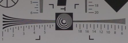

OK, the 5N has some sharpening even when you turn it all the way down. But it also has better detail, even compared with sharpened 7D/550D.
This is a center crop from a resolution chart:
Now try that with a first-gen Canon. But I don't need a chart to tell me the 5N is sharper: I only started noticing that my clips were sharper in my PC than in vimeo when I switched to the 5N; with the Canon, it was so close I never noticed; with the 5N, it's obvious.
About the motion clips and the codec: yes, the codec is worse than that from the Canons, even first-gen Canons, but it's only THAT bad on very fast moving clips. Nothing I actually shot has that kind of issues, so the codec doesn't bother me a lot either. I'd love it to be 10-bit 422 at 200 Mbps, but I wouldn't go back to the aliasing/moire hell of the first-gen Canons just because the codec breaks down with very fast movement.
