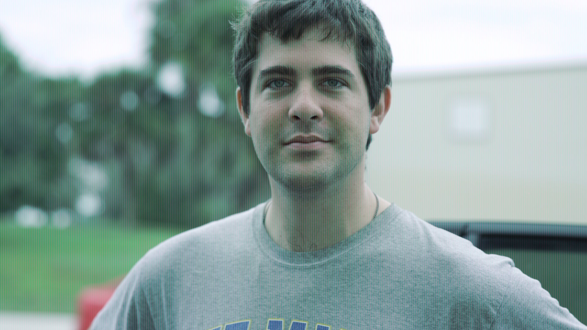

Okay - Some properly exposed, graded and ungraded images. If I need to host these elsewhere I can do. It looks worse on video. I'll try to cut together some 4k examples to upload to vimeo, but my upload speed is not the greatest at home. I shot these this morning, and did an ABB before shooting.
This is at 800 ISO, Clog3, in 6k Raw. Downrezed to 4k. The only thing I did here is apply the Canon Rec709 Lut. If you look at my shirt above the red lettering you'll see alternating horizontal lines of black.
Here is the same frame in 6k (cropped 1:1), pushed around a lot so you can see the lines clearly. There's a much more pronounced purple noise pattern which matches the alternating shades of black in the normal frame.
Here is that same frame with nothing done to it at all, straight raw cropped down 1:1 in 4k.

Not sure what to say. I'm looking at your images and seeing way more noise than anything I see at ISO 800 with a LUT applied off this camera in FF. I tried pushing a similar image of mine severely and I don't see any streaking at all in the shadows.
