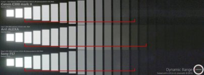

Canon is well aware of the problem as it appeared right from the get-go and they for some strange reason seem to have done little about the problem other than issue a firmware update that did help but never fixed the problem. Check the image from an early test.
https://www.cined.com/canon-c300-mark-ii-review-dynamic-range/
