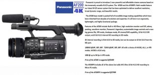

Selfishly I have to say I like the camera, since we DVX users all designed it about 8 months ago! Pretty much the same thing, but no need to change lenses on what Panny made. This was the concept I came up with based on all of us talking about what would be reasonable for a new AF model. So it is a new DVX that's coming, but it's pretty much the best of both worlds.

My only suggestion would be to follow the path they have in the past, by releasing a P2 (even a micro-P2) version of the camera with AVC-Ultra. Even take a page out of Sony's playbook like they did the EX3 and make the lens removable (with m4/3 mount). Call in the HVX300, sell it for $6,500 street.
Would I buy it? Probably not, the DVX200 is more or less what I'm looking for. But an HVX300 like how I described above would compete nicely against the FS7 and Canon cams.
I have the P2 AVC version in my "brochure" as well, and we agree about what the price would be ;) I said $7,999, but it would of course hit the street at $6,999 or $6,500
