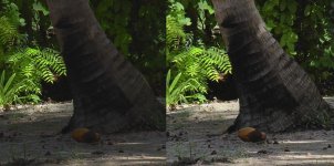

Along with the improvement in gain, comes a big improvement in usability of the Dynamic Range Stretching (DRS) feature. DRS is a way to brighten shadows and tame highlights to increase the effective dynamic range in the camera; it's been on the Panasonic lineup since the HPX170 came out in 2008. However, it's always been of less than ideal value because the shadow stretching was accomplished by adding a lot of gain -- at the strongest DRS level 3, it meant adding up to 18dB of gain in the shadows. On the prior cameras, that meant a lot of noise was added. On the AC90, the noise penalty is quite mild, and so DRS becomes a more viable tool for more scenarios. Here's an example of how DRS helped to tame the deep shadows in a palm tree forest scene.
Exact same exposure, DRS off on the left photo, right photo is DRS on level 3.
