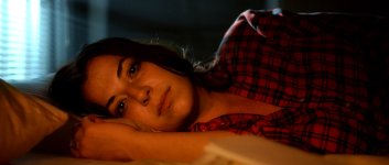

Well, for me this really comes down to aesthetics and utility. I shoot with an AC130 often, and that's my WB process when needed. I wouldn't want to do a fast-paced event or a news-type thing with a DSLR, BMC, etc.
But when I want something just gorgeous, it's DSLR or BMC-type cameras. If I limited myself to a "video" camera for ease of white balance, I doubt I'd be in this business. I assume things like the AF-100 that are hybrids to some extent might make WB easier, but the primary thing video cams offer (in this regard anyway) is the crazy zoom range - I've never seen a similar lens for super-35 or full frame as far as wide-to-long usefulness. And a dedicated WB button, with DSLRs you usually have to shoot a frame and then choose it as the WB source.
Handful of footage grabs - I've never been able to a DVX, HMC or AC series camera to look quite like this stuff. And it seems like more than just DOF to me.
