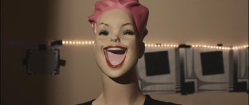

Here's the SLR Magic 2x Anamorphot, GH4 4k 4:3, Sigma 85mm 1.4 EX DG HSM, .64 speedbooster probably around 5.6

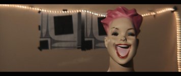

With the SLR Magic 35mm t1.4

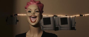

With the Sigma 35mm ART Nikon, .71 speedbooster

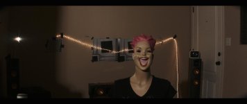

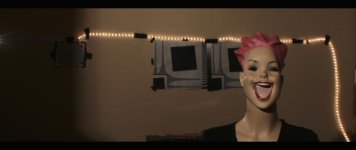

Direct Comparison: Same camera position, just a change of Anamorphic adapters. Taking lens, SLR Magic 35mm T1.4
GH4 3820x2160 with 1.33x strech
GH4 3328x2496 Cropped to 2.40
