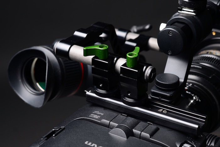

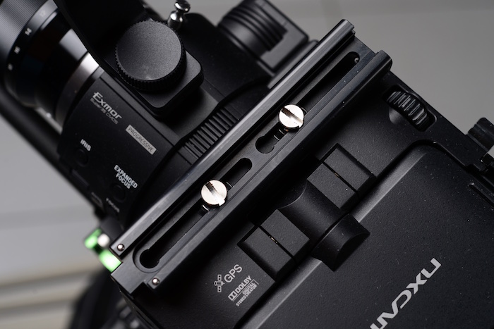

Still waiting on one more forgotten part to be delivered until I can mount my Kinotehnik EVF. I was happy to find this Chrosziel cold-shoe rail to fit the top screws on the FS100. The 4.7" rail fits the top of the FS100 nicely (though, I had to put 3/8" thread adapters onto the 1/4"-20 Chrosziel screws to fit the Sony threads). This is where the 15mm rail for the Kinotehnik will mount. I've decided to create two LWS rail systems: 1. Studio set-up with 7" monitor, 2. ENG set-up with the Kinotehnik EVF.

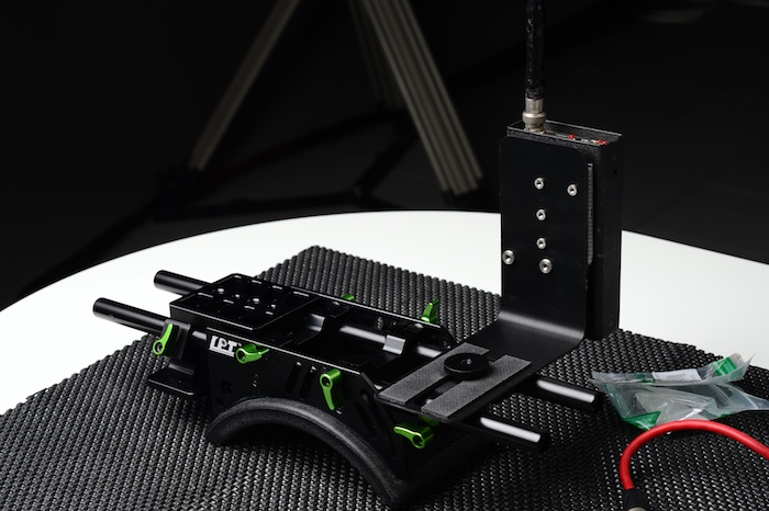

Now, the quick-release plate I need to build the second rig is on back-order, so my handheld rig will have to wait. This rig is proving a bit more tricky to design--note that the bridge-plate shown here is mounted upside-down for a lower-profile. I may need a second dovetail to extend the mount rearward for a proper CG, but I'm really trying to keep the weight at a minimum on these builds, so the less metal the better. Here it is so far, with my Lectrosonics receiver attached:

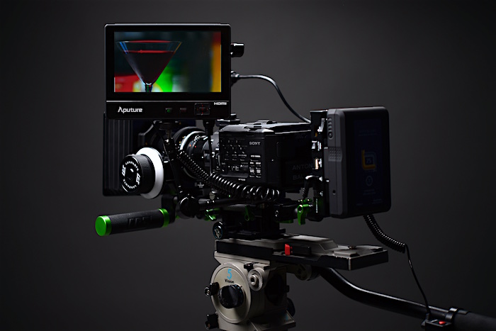

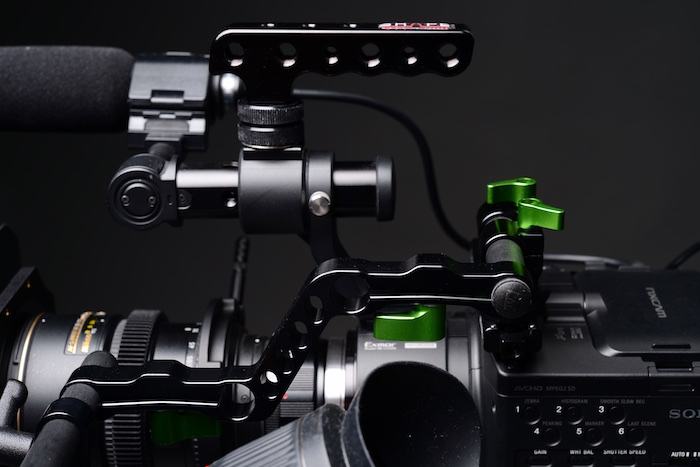

I power the 7" monitor (when in studio configuration), and the Kinotehnik EVF with a Gold-Mount Switronix brick (the only non-Anton Bauer bricks I could find which are still compatible with my Anton Bauer quad-charger), so the Gold-Mount adapter will go on the rear. I'm still toying with handle extension ideas, but I think a simple rod extension using a swiveling Shape bracket may be good enough.
I finally received my cold-shoe rod brackets that I forgot to order. I chose not to use the mount included with the Kinotehnik EVF (it's heavy, and I had no idea how it's supposed to tighten on a non-locking cold-shoe). Instead, I used two 15mm rod brackets, screwed-down tightly onto the Chrosziel rail. Adding a second cold-shoe bracket made for a really solid EVF mount. I used an offset bracket to re-position the EVF more forward:
By the way, I'm pretty satisfied with the Kinotehnik EVF (purchased used off of eBay, but looks brand new). It's bright, sharp, and has almost no lag (it does have some). The plastic-ey diopter mechanism is less than ideal, but it works just fine. The included Kinotehnik DC cable works as it should when plugged into my Gold Mount brick adapter's D-tap. Note: Always be sure check the polarity of your D-tap, since some D-taps are un-keyed, and reversing the polarity will fry whatever you're plugging in if it lacks protection circuitry (which many devices lack).
