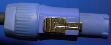

Okay, so ... exploring the idea of making an extension cable that might salvage this thing for use in dialogue situations... if the ballast could be put in another room or behind a door, it might be fine, so... a twenty-foot to fifty-foot cable might make it worthwhile. Step one would then be to identify what type of connectors these are. Anyone have any idea where I could get some of these?
I've probably seen ones similar to that around but you never know and there could be little differences. I would just contact that company and see if they can sell you another one if you want to stick with that. The best thing to do though would be just to replace the whole connector with a good metal one. Something in the 1" in diameter size or greater with plenty of good spacing between the contacts. A "bayonet" type connector which is like a 1/4 turn quick lock military or aviation style connector. Like Amphenol GT-PC series is what pro ballasts like our 575/1200 use and the Arri 575/1200 also uses that connector as well. Pricey but its the best way.
http://www.qscomp.cz/Pdf/GTseriesReverseBayonet.pdf
http://www.amphenol-aerospace.com/new/PDF/12-024-8_GT_Series.pdf
Thanks bclighting, that is what I had determined after much googling and stumbling across the Neutrik powercon -- looks like it may be exactly the same, probably a knockoff version of it.
I had contacted the seller to let them know that this unit is not usable for movie production as-is, and could they identify the connectors so that I could investigate getting an extension cable made. The seller responded by saying that not only would they identify the connectors, but that they would make up an extension cable and express-mail it to me.
That's some pretty amazing customer service, especially when you consider that the unit was sold with a 7-day money-back guarantee! Optimism is beginning to creep back in... :thumbsup:
