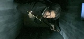

Here's a couple I posted in earlier threads, slider bolted to the ceiling for straight-down & spinning shots - screwed a 2x4 to the ceiling, and bolted the slider to it. I was able to reach over the set wall and do spins and slides; there are two laundry line pulleys and rope to get the camera to the side of the set wall for focusing, adjusting, etc. An assistant would pull it back to center after I hit "record", and the ropes worked great for sliding.
Shot was a sort of "guy in a cell" where I built a 4' x 4' room - we clamped the front wall in after the talent was inside. There was also an LCD clamped to the outside of the set wall - I stood on a ladder and watched the monitor.
Frame grab:
Final footage - there are also shots of a girl in bed and on an exam table where I used the slider on a ceiling or munted overhead - great way to get a camera looking "straight down":
