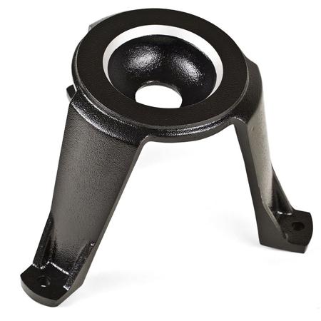

Right now I am either attaching directly to a spare set of legs via 3/8" screw or going on my tripod head via quick release, and I have a bogen 503 head on the carriage. but i want to use my sachtler head and legs without losing bowl functionality.
So i am looking for a bowl adapter (a hi hat) that would mount to the carraige that would allow me to mount the bowl head and adjust. i assume from the pictures the bogen 325n doesn't allow the bowl to adjust it just locks it down - is this correct? I'd also similarly attach a ball to the bottom of the rails so i can throw those on my legs and adjust. Is anyone doing this and if so what are you using?
Thanks again !
Just to clarify what I'm thinking of doing.
Thinking of using a 75mm Hi-Hat like this - http://www.adorama.com/images/large/AGHH100B.JPG
Attaching the three legs to a small steel or plywood base and attaching that base to the carriage.
Then attaching this half-ball http://www.adorama.com/images/Product/BG520BALLSH.jpg to the underside of the rail.
Then I could fairly quickly take the 75mm ball head off the sticks, attach the rail to the sticks using the half-ball, and attach the head to the carriage using the hi-hat. You could then do angled slides while keeping the camera level on top....and be able to use your "A" tripod legs and head.
Is anyone doing this? And if not does anyone see a reason why it wouldn't work?
I do wish i could find a hi-hat that didn't have such a span on the legs and could go directly to the carriage. Anyone?
