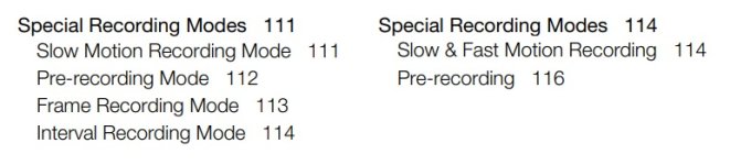

Hey Barry, do you see an interval mode for timelapse on your C500 II? The C200 has one. But I've not heard any reports of the C500 II having one.
I do not see one mentioned in the manual, and haven't come across it in the menu's. I'll look when I have a second.
