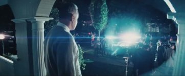

Spielberg's film is also a period piece and meant to create a sense of time and place.
Take a look at the image in the above post. Forget about the lens flares. Look at the curvature of field, like the film was wrapped around a ball. That sense of depth and space is unique to anamorphic imagery. 35mm wide angles are a bit different. So are 65mm. It is a unique look. Not better or worse, just different.
