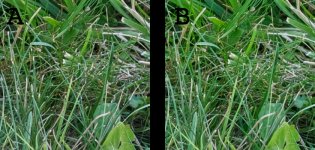

I always used high quality filters (like B&W) on my cameras. Last week, I decided to buy a $5 ND (.6) plastic filter from ebay, just to see how "bad" they really are. I expected it to have a considerable color shift and to decrease the image sharpness.... which surprisingly doesn't seem to be the case, at least I can't see a difference between the bare camera and the camera with the ND on. I just can't believe that a $5 filter can be that good, something has to be wrong...
Can you tell which one is which? One of the pictures was shot with an ND .6, the other without. I compensated for exposure by adjusting the shutter speed.
(100% crop)

Not sure how much you can tell with this shot. Its small, fairly even contrast across the shot. Theres other variables as well like lens it was shot on.
seems "B" will be with ND(2stop) + longer shutter speed, but that is very depend on shutter speed changes between shots .
By the way, these shots are extracted from full resolution RAW still images and not from a video file. I will reveal which shot is which tomorrow, and I will also do some more tests that feature more colorful subjects and different lighting conditions.
By the way, the pictures were taken with a 28mm zeiss contax lens at f5.6 that was mounted to the camera with a cameraquest adapter ($189)...
