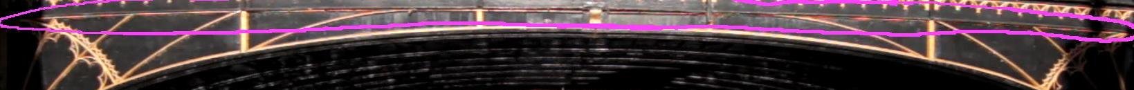

heres a case from a bridge i filmed...
the highlighted broken red line has gaps that move through the footage...the line is actually a complete red line...this is the worst case I have found, some other footage of wavy roof tiles is bad but they are a long way away.
Could be an idea to mask then blur worst areas in ae.
