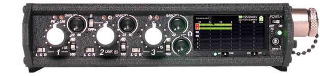

Here is a concept photo I shopped for a 302 with on-board recorder
