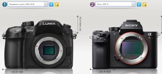

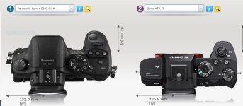

The inference from the body size graphic you posted between the GH4 and the A7R II, is that the body size of the GH4 is slightly larger than the A7R II and it uses a sensor that is 4 times smaller, and perhaps because of this the GH4 does not overheat. ( i.e. the larger body size relative to the sensor size takes care of the GH4 heat )
So would a larger body size be able to handle the heat from the A7R II / A7S II components and not overheat ?

The GH4 is likely to be generating far less heat internally (as pointed out) as it's physically slightly larger, but with a smaller sensor with much poorer dynamic range.
The A7rII is smaller and heavier, with a larger EVF, much larger sensor and an IBIS mechanism. It feels like you're holding a brick compared to the GH4, its much more dense. I'm sure the smaller EVF, smaller sensor and larger body and no heat generating IBIS does make the GH4 better in terms of heat dissipation. Looking at teardowns of Sony cameras show no wasted space. Your last question is for Sony's engineers. I haven't had any overheating issues with the A7rII, so for me its not much of a concern. But it would be nice if Sony solved the problem. Samsung's processor does the job without overheating, but its not a apples to apples comparison. Hopefully in the next generation Sony will introduce a new processor that's more efficient - or a more effective heat dissipation setup.
