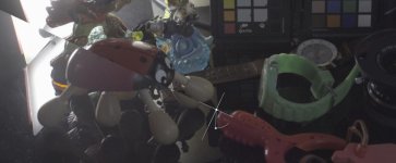

Samuel,
Here's a side by side of A7s and A7sII both at 3200. Both Slog2/SGamut. You can see clear differences for the reds. The two 50mm lenses flare differently hence exposure differences, the A7sII had a voightlander 1.5 and the A7s had the contax zeiss 1.4. Needless to say the A7sII looks like how the scene was.
So i think this may well evidence that the A7s had some seriously screwed up SGamut science. To be honest so far i'm not seeing that much difference between SGamut and the .cine version.
In addition here's a screen showing the YUV comparison between Slog2 and Slog3 both recorded off the A7sII on the O7Q. You can clearly see the encoding difference. The waveform is just displaying the Luma, the Y part. The Slog2 is making more of the space and given the same clipping point you can see that Slog3 could hold a lot more range than this camera can deliver.
Now the big question is internally how is this encoded, especially in the XAVC files. Is it as simple as 0 to 255 integer values for the luma channel? Or is the encoding done differently? In other words is Slog3 only using code values 30 to 210 out of a possible 0 to 255? If this is the case then Slog3 will not be able to represent tonal values as well as Slog2 (which in turn is only borderline good enough compared to the cines).
This is made more difficult with the ProRes from the O7Q because these are 10 bit files, so 8 bit stuffed into 10 bit files but in order to read them via QT the pixel format is r4fl (that's 32bit YUV) but when you ask QT for that format it always dithers the image. If you ask for 16 bit YUV the range is different and it dithers. Only in 8 bit will it not dither but then you're not actually asking for what's in the file. Does that make sense?
So if we cannot work out the encoding scheme then we need practical image tests to eyeball.
https://www.dropbox.com/s/okxbj74xrvxig5u/yuv.jpg?dl=0

As usual, great stuff paul. They most definitely resolved the issues of S-gamut a7s. I will be curious to see how well slo3 sgamut3 grades with all that information squeezed in there. I could see the same issue we had before where the colors stayed washed and faded no matter how much saturation we put in - the only solution was to crank in camera saturation to 20+ . Keep up the good work.
Samuel,

Awesome stuff, paulcurtis, thanks a lot. It's great when first users are really knowledgeable.
Looking at this sample... WOW, that's a huge difference! But it doesn't seem like a fixed-sgamut kind of difference to me: it looks like a much lower noise floor coming out of the sensor. Remember how the a7S had much lower DR than the a7 or the a7R in RAW stills in the dxomark test? Looking at this, my first guess would be that they did a metal spin on the processor design, keeping the basic design but moving a bit some routes in one of the layers to fix crosstalk issues or something like that. We'll know if this is the case when the dxomark test comes out.
So that's the good news, now for the bad news... by definition, slog3 has 1.3 stops more DR in the highlights than slog2 (see the curves here), but it seems the a7S II is not fillling that extra space: there's a hard clip at exactly the same point. If that's the case, the DR improvement will be a lot smaller than I expected (it will go from 2 stops, 1.3 from the highlights and 0.66 in the shadows, to just 0.66 in the shadows).
But also this test shot has the white clip coming too fast for this to be measured, it's a test for something different. The easiest way to check the white clipping point this is to point a strong light against a wall, close and at an angle, and set the camera so there's clipping in part of the wall but not all. Shoot with both cameras, and see if the clipping point is closer to the light on the II with slog3.

Thanks Samuel,
The purpose of that image is just really to show the difference in colour with both being SGamut, perhaps it's not so obvious where i've got the wipe between the sides but the reds are totally different between the two. And red has *always* been the issue.
I'm going to do some more controlled noise tests this evening i hope, and also shoot some back lit wedges for range.
I'm not sure there is any improvement in DR overall. Certainly the noise is better. I don't know whether they're just exposing up and taking down a stop in camera now, i don't think so though but it's always a possibility.
The original DR of the A7s didn't really fill Slog2 either, and certainly not Slog3 but even so i was still surprised how low it clipped. So before i really put it out there i want to double check what i'm doing and looking for.
