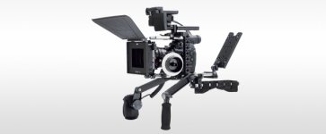

Manufacturers like ARRI, Woodencamera or bebob are putting rigs that are simple, reasonably priced, extremely ergonomic and VERY light. Here's some example:
Baseplate, Rods- at the right height for MBs!- top and bottom, handles, pad, evf arm, ARRI rossettes, balancing plates...and still room enough to fit any further aks like Wireless RCVs, shotguns, etc. Add a Batt distributor on the back, for power+counterweight, done.
Those are from bebob but the same is the case with ARRI and WC. Plus those rigs are universal and fit any camera.
That doesn't look compact or lightway in any way. The Axis is imho the best EVF holder right now and if you want to use the C100 as counterweight as well, there is no way around it. Besides the fact that Bebob doesnt sell the cable for connecting the original handle to the body. You have only 2 options: Zacuto or Denz
Have you lifted the bebob? it weights nothing, really. As for EVF support, both the bebob, WoodenCamera and Tilta offerings are miles ahead of the zacuto, which looks like a school science "terminator" project in comparison, sorry.
ARRI also makes relocators for the C100/300 handle, which can be attached to rossettes just at the baseplate, so you don't even require rods and you can better balance the package, as per in the image. It also leaves the rods free for the Mattebox, etc.

edit... and yes if you want a ninja go for shoulder rig... otherwise there really is no point in a shoulder rig. The above picture although looking really impressive
i look at it and see no point at all.

You'd need to get some kind of counterweight for that though, surely?
Yep it's not shown in the photo, Movcam uses their swivel battery plate (and V-mount battery) as counter balance. They have cables for C100/300/500, FS700, F5/F55 etc.
