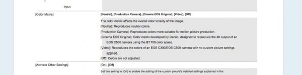

I have a shoot coming up where I may have to match a 300 Mk2 and a C200. CP sharing between the 300Mk1 & Mk2 wasn't possible, and I am wondering if I can take my 300mk 2 profile which I like very much and read it into a C200. Does C200 even have a 'production camera' matrix setting?
I haven't tried it but I don't think it will work. Maybe someone who has access to both can try it? Attached is an excerpt from the manual, yes, it does have Production Camera Matrix.
