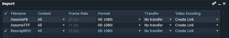

NLE Import dialogue (dropdowns show only the 1080i option):

I can't get it seen as progressive, but always as interlaced.
I can get it seen as progressive just when I rewrap the stream in a MOV container (w/ ffmpeg or ffmbc) although not every time. :-/

Lightworks (I like it quite much, but it's actually a beta); as 25p project.
Very buggy software. I would wait a while until it gets developed a bit farther and becomes stable.
Very likely Lightworks problem . No other software has problems with this.
