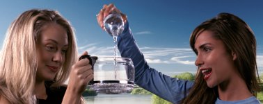

Good 'ol AE 7 + Keylight (1 click) + Levels. First photo downscaled to 25%, second close up downscaled to 75%.
Jeremy - Red #63
