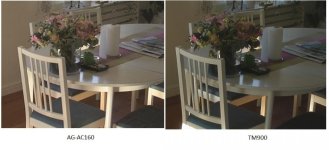

I think I have a problem.
About two weeks ago I bought a used AG-AC160AEJ, used only 23 hours. I have used camcorders for about 15 years filming
family, nature and also some payed gigs. I consider myself a serious hobbyist. I own a Canon HV20, a Canon XH-A1, a
Panasonic TM900 and now a AC160.
The AC160 is really a great camcorder. Fantastic in low light compared to my other cameras, great lattitude, good lens
with enough wide and tele, all controls where one could expect them to be. For the most parts I'm very pleased with it.
But, there are two problems.
The picture is not sharp and it's noisy. I've tried all kinds of configurations but I can't get a really sharp picture
from it. I've tried to shoot clips with all kinds of settings, with aperture between full open to about F4.0, I've tried
to focus on distant and close objects, I've tried different values for Detail and V Detail, different Coring, different
Gamma settings, changed Matrix but the picture won't get really sharp. During test I don't use gain, and ND filters is
used to keep the aperture at F1,6-F4.0. Adding more detail in the setup gives a sharper picture but also adds more noise.
It's hard to describe the picture, but it's like diffraction, it softens the picture. It's subtle and hard to see on a 42"
HD TV, but on my computer monitor I can clearly see the difference between my TM900 and the AC160. The picture from the
TM900 is rasor sharp and more or less free from noise compared to the AC160. Compared to my XH-A1 the picture is sharper
and less noisy though.
I attach a picture, the AC160 to the left, the TM900 to the right. Focus is on the flowers on the table.
For the AC160 all settings are default Scene File 0, (that is 0 for all parameters), F1.7, ND 1/16, 1/60s.
I can see that compression during transfer isn't good for the quality, but I think the difference is visible.
I don't think that the person who sold the camcorder to me knew that there is a possible fault on the camera. As I wrote
earlier, the difference is subtle and must be checked on a computer monitor, on a TV it's very hard to tell the
difference, and absolutely impossible to see if there isn't anything to compare with.
The firmware version is 2.05, the latest downloadable from Panasonic is 3.05, don't know if an upgrade is a solution to the problem.
Do I have too high expectations about the picture quality of the AC160 or is there something wrong with it? Perhaps some
kind of adjustment has to be done to the focus/lens system? I find it strange that the TM900 gives a much sharper picture
than a 5x more expensive camera. Reading reviews on the web indicates that it can produce really good quality, full HD,
low noise picture, so I find my experience of the picture quality very strange.
I don't think that the soft picture is a user error as I'm aware of how wrong settings can give bad results. I've also tried so
many settings but never got a picture that is as good or better than the TM900.
The camcorder is under the three year warranty program so I think there will be no problem to get a check of it, but I
think someone here on this forum can give me some input first. I'm here very often to get info and also give info
sometimes so I know there is a lot of knowledge here.
Regards,
/Bo

To my eye, the 160 is out of focus. I assume you have the focus detail lines engaged? Keep in mind the 130 and 160 cameras have auto focus issues with contrast. Use manual focus as much as possible. Also, scene 1 is a default. Try scene 3.
Lastly, you may have a defective camera that is not registered properly relating to lens to target area.
My camera is sharp as nails.
I set focus manually on the flowers on the table. Hardly ever use autofocus. I have also tried different scene files but with no success. I will contacat Panasonic and claim a warranty check/repair.
/Bo
/Bo
Bo, expanding these shots greatly I see that these shots cannot really be compared as they are quite dissimilar. There is a huge amount of edge accutance on the right hand picture. This electronic sharpening will give the appearance of a sharper shot but when enlarged is quite ugly. Also the contrast range appears compressed on the right hand shot. This would also give the appearance of extra sharpness. I would repeat the exercise with better synchronised exposures and do a bit of pixel peeping on a large monitor to check objective sharpness. The 160 is capable of very subtle and extended gradation. Worth another look anyway before scooting it back.
PS: I looked at these at 500% magnification and it is clear that the right hand shot is under exposed compared to the 160 and seemingly much lower resolution. Look at the jaggies down the rear chair back when compared to the 160..
Cheers!
Rod

I also have suspected some kind of electronic sharpening on the TM900. After all it's a consumer camcorder.
But I don't think that's the problem here.
The example I attached is perhaps not the best. I've done other tests and the TM900 have more details in the picture at full wide, compared to the AC160.
I have the experience that details can't be added with electronic sharpening, just edge enhancement.
I've done some tests outside filming flowers. If I zoom in fully on objects, the camcoder is razor sharp. Compairing fully in zoomed pictures from the both cams,
the AC160 is better than the TM900. Sharper, more details, more natural colours and better lattitude.

Bo,
"if I zoom in full on an object and adjust focus and then zoom out to full wide, the picture goes out of focus."
This is indicative of a back focus problem. The service center will likely perform a "software alignment" that will (hopefully) fix the issue and bring the camera up to spec. Unless there is a physical fault with lens elements or tracking mechanics (ie: a bad lens assembly). Fortunately, you're still under warranty.
Ken

About the camcorder. There was probably some kind of focus error on it. The protocol says that they have done
a back focus adjustment. I tested the camcorder yesterday and it's now much better. I also have a feeling that
