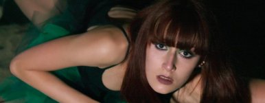

This one clip is @2500 at 1:56...pretty destroyed. Wondering if that's up from 800 or in the 2500 setting.
The shot before it is at 2500 iso and looks clean. I'm gonna say the shot you mentioned in a post re-frame.
It could be, but you normally wouldn't do that on a 4K timeline.
It also doesn't look soft(er), just noisy; red chroma in hair, a bit of FPN. (Just curious what happened to that shot.)
I don't think its reframed, even though at first that made sense. The DOF appears to be shallower versus the wide even though it says it's the same lens. Actually in the 4K I see the same noise pattern with similar coarseness but it is much less prevalent since there is less shadow area in the frame. Does seem like surprisingly coarse noise for such a high res camera, but I'd guess that's just what was leftover after noise reduction since the character of the noise indicates significant noise reduction, possibly just in-camera from trying to fit it into a 150Mbps file at ~25:1 compression?
I think this is somewhat expected given that by most accounts, Varicam LT ISO5000 noise matches 800 better at 2000-2500, so maybe EVA1 ISO2500 is best exposed at ISO1250 if they design and rate ISO in a similar way. Does draw into question the usefulness of ISO2500 if it may trade 1.6 stops of clipped highlights for 0.6 stops of cleaner noise.
