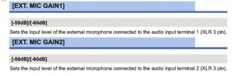

You can also try switching input levels and see which performs better with your setups:
