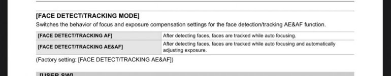

Facetracking seems to only work in FULL AUTO everything mode which is crazy.
This is unacceptable. I haven’t received mine yet but I read some of the manual. It shows that there is an AF only switch, but when it talks about face tracking it shows AF/AE. Is there no way to shut off the AE portion in the menu somewhere? If not this is something they need to add via firmware because it’s insane in 2022.

Apparently there is a way to disable the auto exposure linking to the face AF. It comes from the factory with it enabled unfortunately.
Yes, it is a stupid limitation. I definitively would use facetracking but not in FULL AUTO MODE. So now, I'm stuck at zone AF.
Check out my post a little higher up with the image attachment. It seems like there is a way in the menu to disable the auto exposure function when using face tracking.
Yes I saw that. However is *seems* that you still have to slide the camera switch from Manual to Full Auto mode to be able to activate the FaceTrack with or without auto exposure. So maybe you override some of the Full Auto stuff in the menu in so it's not actually in 100% auto everything but the switch is still in the Full Auto position, which is still crazy if that's the case. I'll see if I can find out.
