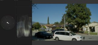

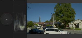

But looking at the Jag fender, it's clearly clipping in the Cinelike D shot. If you clip, there's nothing to pull back. Plus, look at the shadows. Mine seems lighter and the V-Log seems darker.Example of highlight rolloff and DR.
Notice the red circle around the fenders line in the highlights.
Leeming: Line does not complete. whack greens.
VLOG with Neumann LUT (called "nothing Crazy). Line in car fender almost makes it. Far better shadows and greens are natural.
VLOG with J. Miller LUT. Line completes. Wonderfull highlight rolloff. Natural Greens.
Leeming CineD vrs J.Miller VLOG Lut for skin. Notice the greens and the highlight rolloff of the palm of my hands (lets just say that a fortune teller would give me a false reading using the CineD).

HIGHLIGHT DR AND ROLLOFF!!! NIGHT AND DAY! Look at fender of car.
Leeming Cine D:
VLOG with J. Miller LUT. Look at highlight separation of car fender. You're gonna state there is no increase in DR of VLOG vrs CineD, Mr. Leeming?
Can I ask, for the sake of fairness, that you post the ISO and exposure info for comparative shots, so we know they have the same exposure? And that you expose to the right for Cinelike D, such that nothing is clipped using the Zebras at 105%? Because my feeling is, that fender shot, with nothing clipped, I could easily bring back the highlights below 90% IRE like V-Log L does, and get the same rolloff characteristics.
