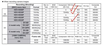

Cheers for that. 1080i exclusively would put the kibosh on things but I think (and hope) you can set the output to various 720p flavors too in the menus. I’ll hopefully have the opportunity to test it out soon and will report back here.
It looks like you can from the chart but you have to be in the HD (HDV) mode and recording in 720/60p, 720/30p, or 720/24p. (The arrow means it follows the recording format which is why there is an arrow at the top of the column for 720/60p.)
Back then it actually wasn't uncommon to have one framerate like 60p being outputted even if you were recording different framerates.
Today, the SDI/HDMI usually follow the internal recording settings and output different framerates.
Excellent! Super helpful chart, thank you. May seem like an odd concern, but do I just need to set the required HDV to have the associated signal automatically come through the SDI or do you also need to be recording to tape at the same time to have it work? Wouldn’t be too enthusiastic at the thought of having to mess with mini dv tapes again after all these years!
I'm not 100% sure with that camera, but I highly doubt you'd also need to be recording...I guess you'll know soon when you test it. :cool:
