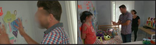

Would you care to share some examples?
Sure.
The first was the first day before I noticed the difference. All camera settings from exposure, WB, PP etc all the same:

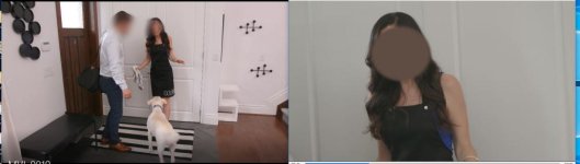

The second is after I noticed the problem. I setup both cams with the same lenses and light source and manually adjusted the Wide DR color profile's white balance until they matched. On the day (using different, mixed lighting conditions) this is what the result was

I wish I could help but I can offer that I too rented an extra C100 for a shoot in January. I reset the rental camera to factory settings, then transferred my custom settings from my camera to it. All appeared well but I didn't shoot tests (bad move on my part). Handed it off to my other camera operator, same deal, we shot WDR and when I got the footage into post, they didn't even come close to matching. I shot chip charts and white and gray card when I could but definitely not for every setup or lighting change, the shoot was very run & gun. The rental camera had a washed out, low contrast greenish look while my camera looked great, like typical WDR, my favorite setting for the C100. Actually if I look at your frames above, my camera looks like your first frame and the rental camera looked like your second frame, only worse. Luckily the client was not picky about matching the cameras precisely so with some heavy duty and repeated pass color correction, I at least got them into the same neighborhood.
All I could figure was that different samples have different burn in or hours, causing the color matrix to deviate? I never thought to check firmware versions. Good suggestion drummonb
Just an update. I returned the other camera to the rental house and got another one from a different supplier. The images now match perfectly.
Thanks for the responses, everybody!
