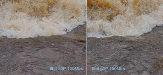

I have wondered why I cant see macro blocking in my GH5 4k 60P file like earlier with GH4 8bit 4k 30P. I tested with complex motion and the result is surprising. 60P is much cleaner than 30P.
Yup same concept that benefited 720p 60p broadcasts and why they could get away with a lower bitrate and still look very good and why 60p 1080p can also look spectacular at a less than 2x bitrate compared to 30p. IPB encoding is all about changes between frames and the more frames you have the less change there is with each frame. Same reason why optical flow type slow motion in post works much better with a 60p source than it does with a 24p source. Much easier to predict and create motion vectors due to a much smaller change between frames.

Indeed but 4k 30fps is slighty sharper than 4k 60fps ( only if you pixel peep =) ).
GH5 4k 8bit 30P and 60P are made from the same sensor data. IQ should be identical before compression which is better in 60P.
