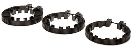

So I've got a zoom on reserve for my Red but like a lot of people, I will be using Nikon primes in the mean time. I read that a follow focus is a must and Jim mentioned that a gear-down will be necessary so you can turn the focus wheel a lot more within the 90 deg rotation of the focus barrel that the Nikon glass gives you. So...where can I find a follow focus that will mount on standard rods that will interface with the Nikon lens that has this crucial gear-down? Or, am I at the mercy of some 3rd party to make such a thing? How good would the IndiFocus be for this? It doesn't appear to have gear step-down.

The Redrock focus gears are set out from the Nikon lens by about a 1/2".
This adds distance and thus precision to the focus throw. It's quite an elegant design really.
yes redrock did it right.. the rings they make share a constant diameter (to some degree) and allow you to interchange lenses without needing to adjust your follow focus angle that much between the changes.

Sorry, but the Redrock follow focus is crap and their ring's diameter is to big.
I love Redrock, and think highly of their product but not their F.F.
Get a chrosziel F.F. and for the lens, I use the ring Zacuto makes, they work great.
I don't know about their FF but I totally disagree on the rings, they are excellent and a total bargain.
