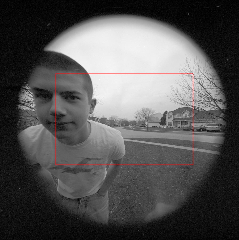

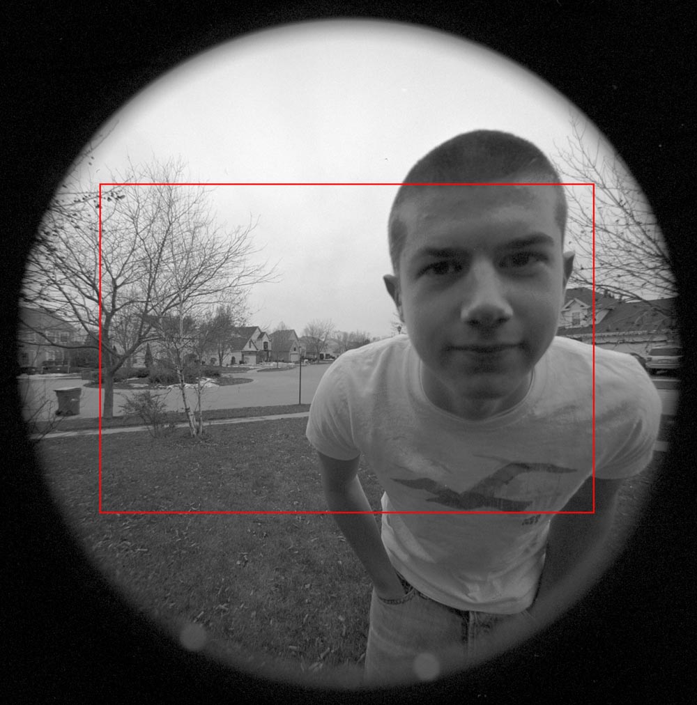

I'm actually getting set up to prove to myself once and for all what's *really* coming out of the back of my lenses. I did a couple of tests onto B&W film but will do the real thing under more stringent conditions, onto color film. Here are my 24/2.8 and 24/1.4 lenses, captured onto 4x5 film so you can see *everything* coming out of the lens. For reference purposes I've drawn a to-scale 24x36mm rectangle on them.
http://www.betlikeduncan.com/duncan/redrock/lenscharts/canon_fd/lenscircles/24_14_boxed.jpg
http://www.betlikeduncan.com/duncan/redrock/lenscharts/canon_fd/lenscircles/24_28_boxed.jpg
Note that the 2.8 has much worse vignetting at the edges of the lens itself... but neither one of them has vignetting anywhere near the area that gets put onto film. And yet, when you mount the 2.8 onto an M2, the resulting image is *awful* due to the portholing caused by the ground glass interacting with the small exit pupil of the lens. These fiber screens should take care of that (I eagerly await the results of the impending 24/2.8 test!) but I'm also looking to avoid introducing any new edges that cause shadowing, in the adapter rig itself.
