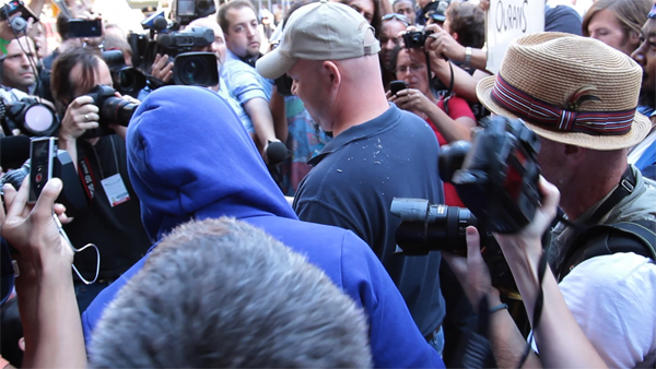

It was not. That's what was asked at the Q&A of the SCCE, people insisted that the DSLRs must not have been properly focused. And you have to consider -- they had 12 cameras there, and every single one of them used the exact same lens, and consistently they got focus exactly correct on nine of the cameras, but somehow managed to mess up focus every single time on the DSLRs? With dedicated camera ops for every camera? Nope. They were extremely meticulous. They didn't miss focus.
Weill I said it looks OOF. And I seem to get non-soft results with a wide on my 7D so perhaps I'm missing the point. For example see the detail in the gentleman's hat to the right of the Koran burning gentleman in the center. What I do see in analyzing my footage is I have to be very careful about the frame I select due to the motion. This is with a Tokina 16-50 zoom down around the 16mm end.
I think the point of these comparisions is to show the relativity of detail and sharpness. The DSLR will look sharp against some cameras and soft next to others. It really is a sliding scale. Motion did not play a part in these tests as the cameras were stationary and a lot of the scene was not not moving. The fact is the DSLRs took it on the chin in this test for detail compared to dedicated video cameras. They still can make nice images, but not as nice at 1080p to the other cameras.
The whole key here is that the footage was viewed at real resolution. No internet small frames which hide all imperfections.
The hat is much closer so the pattern is bigger. That's why when you use a resolution chart it has to be frame properly.

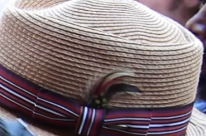

Look at this close up of the hat. The outer big pattern is clear (low resolution), but the middle of the top of the hat has turned to mud because the pattern got smaller and it couldn't be resolved. You may have a higher resolution image, but that only affects the frequencies at which the artifact occurs.

Ha ha no kidding. Shooting this type of stuff with a DSLR is a PITA and I agree there are a lot of tradeoffs image quality-wise. Here's the actual crop of the hat from the original frame -
Right. Still loses detail in the crown. Then move the hat 15' farther from the camera and you'd have the situation with the dress.
