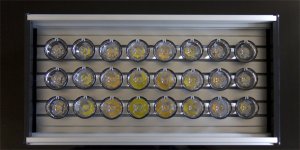

"LEDs won't do a damn thing in sunlight" How about one of these. A 64,000 lumen one is on the drawing board, slightly larger though.
View attachment 80673View attachment 80674
