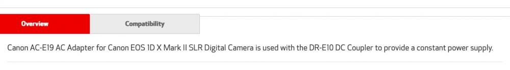

The adapter I linked and coupler you linked, when used together will power the compatible DSLRs.
The adapter alone should power the c300 iii/c500 ii (according to Q&A).
It's one of the first things I checked but they didn't say anything about it being for the cinema cameras and it's nowhere on the C300 Mark III's page.
But its description is pretty straightforward and maybe hasn't been updated. (And clicking compatibility doesn't show anything.)
That would be great if it works though.
Yeah I'd say they haven't updated the description. Being under c300 iii accessories/batteries & power, along with the answers on the product page is good enough for me though.

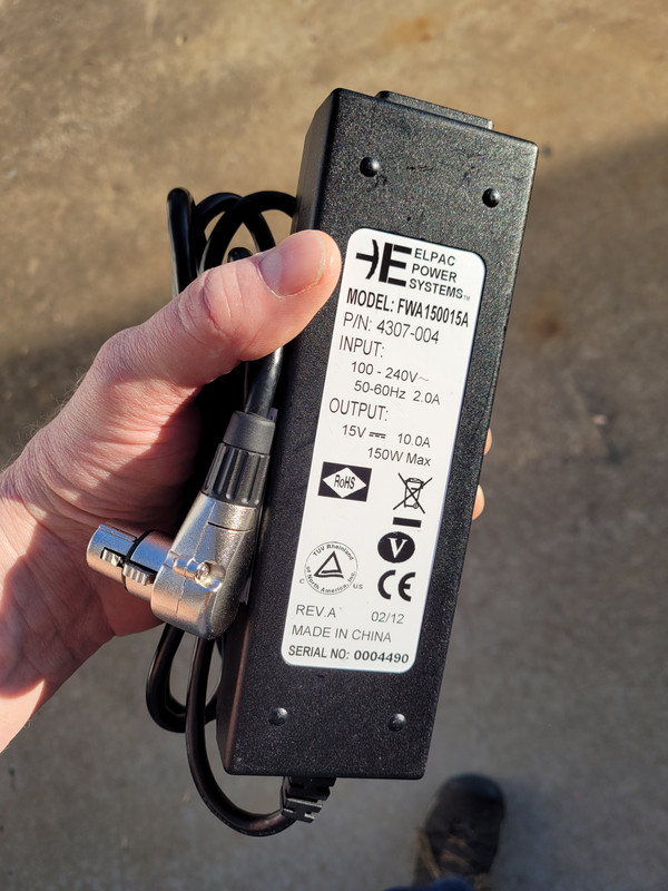

It's a pretty common power supply. I just used an extra one I had from my Red camera and put a 4 pin XLR plug on it. "Massive and heavy?" It weighs around a pound. The thing is, the camera needs the amperage, so the power supply will be large ish.

This is the power supply that came with my Red Epic and that I just repurposed for C300 MKIII. It weighs right around 1 lb. I don't know what a WC PS is, but if it's the official over priced Canon power supply - LOL.
