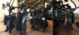

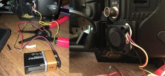

There is a similar issue with several Sony cameras, among them A6300. There have been several suggested solutions. One that seems to work reasonably well is adding a small external fan (a PC type) onto the camera rig/cage. I have no idea if this will solve C500 heat buildup/fan noise issues but, just in case, one might head over to the Sony A6300 thread and explore the proffered recommendations further.

We know the fan is a problem in 4K after 6-8 minuets, I think the electric micro fan set up that was made a couple years back may help if anyone with a C500 needs to record a lengthy 4K interview, and recording in 2K seems to be fan free! Anyway I'm hoping to not return the C500 and make it work. The other option is upgrade to the C300 Mark II, just no 60-120p in 2K and 4K :(

I will definitely be making a trip to Fry's in Burbank to see if I can fashion a little fan rig like the AbelCine one that was posted before. It shouldn't be too difficult. It's a minor problem, but it does require a solution.
