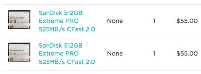

P.S. I just checked a LensRentals order (something was telling me to) I placed a few weeks ago - which included the C200B - and I totally forgot that I went for the 512GB Sandisk cards that time and not the 256GB ones I always rent.
I filled these cards up continuously over 3 days with no problems. So Sandisk's (not really much of a surprise) 512GB cards work too.
