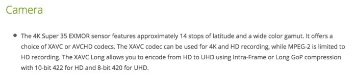

Thanks. If it took 2 secs I would have found. For example looked on BH and sony site to see if FS5 did 10 bit 422 4k internal. Only say 4k internal. Nothing about 420, 422 or 10bit. Details like bit depth etc seem hidden for cameras. Need much digging.
It's literally the first thing that's said about the camera if you don't count the first two introductory paragraphs:
