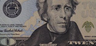

I was curious about how my GH2 with Quantum v2 hack would fair against my XF300 in terms of resolving power. I knew that the XF300 should (and did) resolve more details, but I was curious as to how much detail my GH2 was getting. So here are the cropped comparison grabs.
GH2 had sharpness at 0, iso 320. XF300 was at -4 sharpness and gain at 0db. Used a Canon FD 85mm f/1.8 lens at f5.6 on the GH2 shot.
I think it's pretty obvious that the GH2 doesn't resolve as much as the XF300, but I didn't expect it to since the XF300 is a 3 chip camcorder that resolves 1000 TVI. The GH2 does very, very well, though in terms of sheer resolution. These are 100% center crops, and the curve of the GH2 grab was adjusted to more closely match the XF300.
GH2 100% crop with Canon FD 85mm f/1.4 @ 5.6:
XF300 100% crop:
GH2 1920x1080 still photo 100% crop with Canon FD 85mm f/1.4 @ 5.6:

Higher resolution photos show way more detail than this, even. The sensor is obviously able to resolve more detail from the FD lens than it's able to process into an HD video picture, so I just can't see how a lens that might be able to resolve even more detail would result in any sharper of a video image. I totally understand what you're saying regarding glass made for digital sensors and glass made for film, but I really don't think the issue here is lens or sensor - it's video processing capability. The sensor easily resolves more detail from the FD lens than what it's able to output in HD video, but it can process that detail into a still photograph.

Totally agree with these findings.
The GH1, GH2 and AF100 all only seem to give about a little higher than 720p resolution to me.
I said that on Barry's AF100 vs FS100 thread (very few people agreed with me - probably because they were only watching the 720p Vimeo file and couldn't see the difference then?)...
I'm not sure why this isn't obvious to everyone else.
Personally, it looks like I did a CG render with too low anti-aliasing settings and slightly too low resolution, then did a blow-up and do a combination of blurring / sharpening to make it "acceptable" 1080p.
Of course, crisp 800p or whatever might be absolutely fine for most folks' purposes.

The gh2 definitely out-resolves the gh1/af100; it is higher than 720, yet not a complete 1080. Halfway. But it looks great, and resolution is one thing that does not concern me with the gh2.

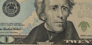

Ok, here goes - I'm not going to label these. Shot with Quantum v2 as 1080p24 video. One is the Panny 14-45 zoom lens, the other is a Canon FD 35mm prime. Both at 5.6. I adjusted the contrast of the FD prime to match the m4/3 lens. Tell me which one you think is which.
If you mouse-over, it says the one on the left is the 14-45. Unless you intentionally mislabled to throw us off, haha.
In any event, the one on the left is clearly sharper.

It is sharper for sure, but I don't see any more resolved detail.
Was gonna say the same thing as DBP.
I don't know if the one on the right is soft focused, though, because the numbers are slightly softer. Left does look sharper. Could be as simple as contrast doing that, though. Either way, proof that even if there is a difference, at least with thees two lenses, is almost negligible.

Hmm, also, it's super subtle but the one on the right's got a bit of color moire in it? On the collar. YES... pixel peeping.
