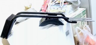

How unlucky am I....I just flew out from Melbourne 5 days ago. I had pre-ordered the Ikan Stealth rig from a dealer in South Melbourne but they only delivered the shoulder pad bit and Rig 1.jpg Rig 2.jpg
so I got a full refund. In a way I am glad that happened because after playing around with the pad, I felt it was not going to be very comfortable for extended periods.
I agree with you 101 % regarding the counter balance issue. That is the only way to go if one wants comfort. I made my own rig a month or so ago complete with counter weights. I have attached a couple of photos. The rig works a treat and it balances beautifully on my shoulder. The only thing is there are no adjustments available for positioning the camera.
