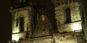

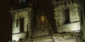

Here are two cropped pictures which show differences between cine1 and wdr gamma in dynamic range.
I would say bottom is cine1 because of the blown highlights below each window, and the top image is WDR since the mids seems about the same as the other image, but you can see the detail in the bricks below the windows.
Yes, you are right, exactly.
If you log out from dvxuser or if you download pictures, you will see the names of files. Both pictures have a very similar colors, but WDR has better dynamic range.
