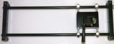

If you're the handy type, i just built one out of an off cut from an aluminum pool fence. 700mm x 200mm . Total cost $28. It breaks down very small for airline travel, weighs less than a 1kg. Works beautiful, very smooth and quick to assemble.
You will recognize the ends and the rails as the powder-coated pool fence, i just removed the middle rail (you can see the holes inside the ends)
There is threaded rod running insider the rails to pull it all together, has door stops as feet and the rollers are available from Yacht Chandler. Carriage is just an off -cut alum box section. Nylon Lock nuts adjust the rollers.

zazzacast, it's almost impossible to get your slider in Australia. Both the NZ and Au stockists of igus rails never reply to product inquireries, Amazon don't ship to Au, so I was foleft with no option but to make my own. The original poster also lives in Au.

Nice, I'm thinking to do something like this but with a mount for tripod.
That's easy to do, i use a tripod or any support on either end. Two of the cheap 500watt garage light stands are very stable if weight is not an issue, can't beat the price.

Here's a sample clip from the DIY slider, as good as may Pro model as far i as i can see. It is after all just a simple wheel on rails.
