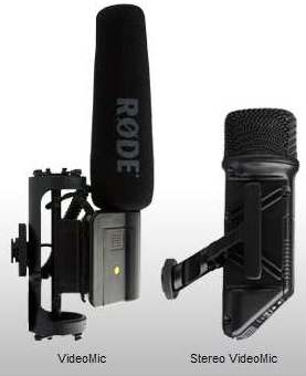

apparently the Rode VideoMic is also good for the GH1. I haven't used it myself although I will probably buy one this week (unless there's a good reason not to!)
Not VideoMic (only mono) ... StereoVideoMic! Or did you mean this?
http://de.rodemic.com/microphone.php?product=StereoVideoMic
In Germany there are (two) dealers, the sell GH1 (red or golden) with Pana-Mic and bag for regular price - 25% :-)
The Videomic is nice for the price, but as DonalDuc said -- it's only mono. (there are very few stereo shotgun mics... and most shotgun mics (except the upper end) tend to have mediocre bass response)

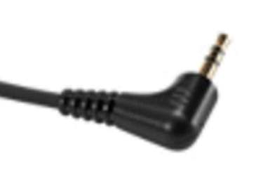

What I'd recommend is a short adapter cable with an L-shaped 2.5mm jack on one and and whatever connector you need on the other end. Plug it in and tape it down so the 2.5mm plug cannot move during your shoot.

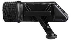

I heaved my Rode stereo videomic out of the cupboard and plugged it into my GH1 via a suitable adaptor, but the result was only mono.
Either the connector on the camera needs a four-pole plug (as I've seen suggested) or the adaptor isn't fitting well. It may need its plastic casing shaved back a bit (on the adaptor, not the GH1!!) but I suspect there's money to be made by someone able to make up a short cable adapter using connectors that actually fit and work. I certainly wouldn't want to try soldering onto one of those tiny connectors myself, particulaly if indeed the four pole version is required.
