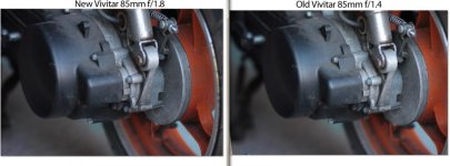

Did some quick tests today with both lenses, interesting stuff!
Took a picture of the back of a motorcycle with both lenses wide open:
Then zoomed in 100% to compare:
as you can see, the new Vivitar lens is a bit sharper wide open. But, that isn't fair since the Samyang one opens up wider (1.4), so I decided to stop it down a bit so that it should be approximately the same 1.8/2.
Here's what I got side by side:
As you can see, even with the Samyang stopped down a tad, the new Vivitar is actually a bit sharper wide open on the left.
But where the Samyang really shined is when I stopped them both down to F/4:
Here you can see, the new Vivitar is still experiencing some purple fringing, whereas the Samyang is pretty darned sharp on the right.
Interesting stuff. I took some other shots of colored objects to compare as well, but I think the rusted metal on here illustrates the best. Will be throwing this into a youtube review as well, hopefully later today.
