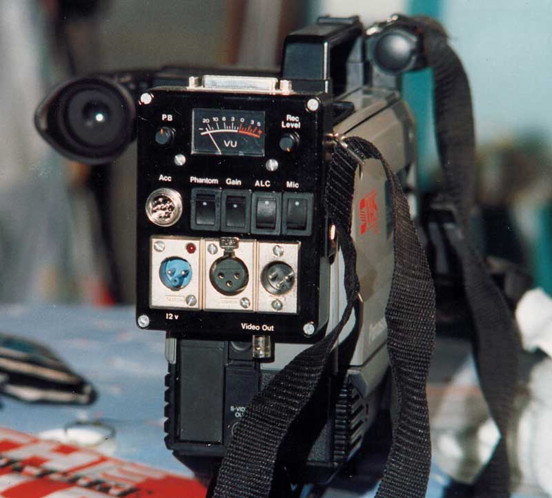

I also remember one other model I had: the AG450, which I heavily modified (variable speed zoom and improved power and audio functions).
http://mike-warren.net/play/060-web.jpg

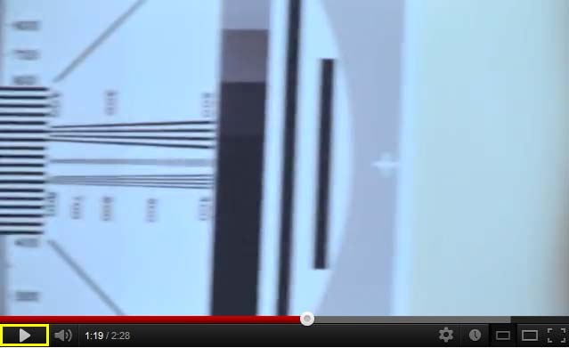

Here is a further test. Maybe not lab quality but contains and covers more of the suspected missing factors such as shape, contrast vertical, horizontal and diagonals.
Do you still have it set up? Can you put the charts the correct way up and test again. No need to post the video, but does it behave the same? The problem I have is that there aren't any vertical lines within the focus area, exactly the sort of situation I think would fool the AF.
Did you notice how it does find focus as you move off the close chart and a strong vertical contrast line appears in the focus area?
Mike there are vertical lines in these charts- Crikey! how finnicky is this focus system? Sometimes it gets there, sometimes it doesn't. In the real world we have to shoot what is in front of us generally. And we don't know what the focus area is - I have asked Barry but he said Panasonic have not published that information. That's why I filled the frame and switched off the area function so that it would not just see the centre area as a grey card.
However, I will set this up and try again in the interests of science as it were, but these are easy targets and if it can hit them once it should be able to repeat.
I understood that with the area function switched off it still gets the data from the centre of the frame, but I could be wrong. It's frustrating me that I have to make so many assumptions, not having access to a camera.
However, if it does the same thing with everything identical in your test apart from the card rotated I'd have to agree that the AF is significantly worse than it needs to be. But it simply can not be as good as a smaller lens on a 1/4" chip camera. The mass of the focus element is probably 5 to 10 times greater in this lens compared to a 12x on a 1/4" chip. (Educated guessing again).
